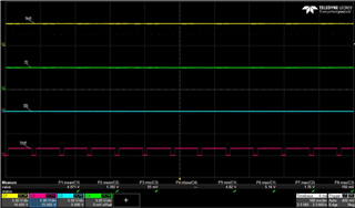

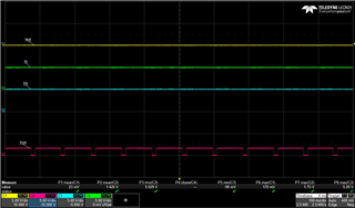

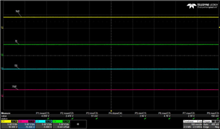

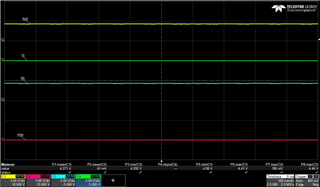

  • Hi Shreyas,
    May I know the Wattage value of the IC?
    The current limit set value cannot be reached under the test conditions below.
    - Current set value 2.5A
    - Voltage: 12V
    - load: 10ohms
    When power is supplied, the current is measured by 300-350mA, but it is thermal shutdown.
    Additional testing.
    Current Limit Set Value : 500mA
    Load: 5 ohms (100W)
    1. 5V, 500mA(IN_High  / EN_LOW)
    2. 7V. 350mA(IN_High / EN_LOW)
    The fault does not turn low even though Vout fails to maintain supply and the current has dropped from 500mA to 350mA.
    3. 5V, 500mA(IN_High / EN_High)
    Fault is Low even though the current is consuming the set 500 mA.
    4. 7V, 350mA(IN_High / EN_High)
    Vout does not maintain normal supply.
    5. 5V, 0mA(IN_Low / EN_High)
    If you change IN from high to low at 5V supply and 500mA, the Fault becomes High and the Vout is shut down.
    Does it work for Standby DIAG mode?
    When the current limit is reached, the fault does not change from H to L (in the EN low state), and when the EN is changed to High, the fault does not become H and comes out as L even though it is consuming normal current.

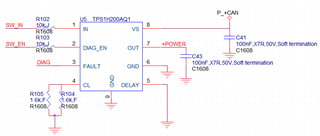

    Please review if the operation is normal or if there is a problem with the schematic.

  • Hi Cho,
    DIAG-EN has to be high for the fault to respond to the current limit.
    The current limit has an accuracy value associated with it so it is possible that in some devices, 500mA is not sufficient to trigger the limit.
    The current limit accuracy is defined for overload condition that exceed 1.5x times the current limit. Slow ramp can affect the accuracy as well.
    Once the current limit is triggered, the device will hold the current at the specified value until it heats up and turns off. It will retry when it cools down enough as mentioned in the datasheet.
    For more information about the current limit and accuracy please view the following document: https://www.ti.com/lit/an/slva859b/slva859b.pdf?ts=1700597246215
