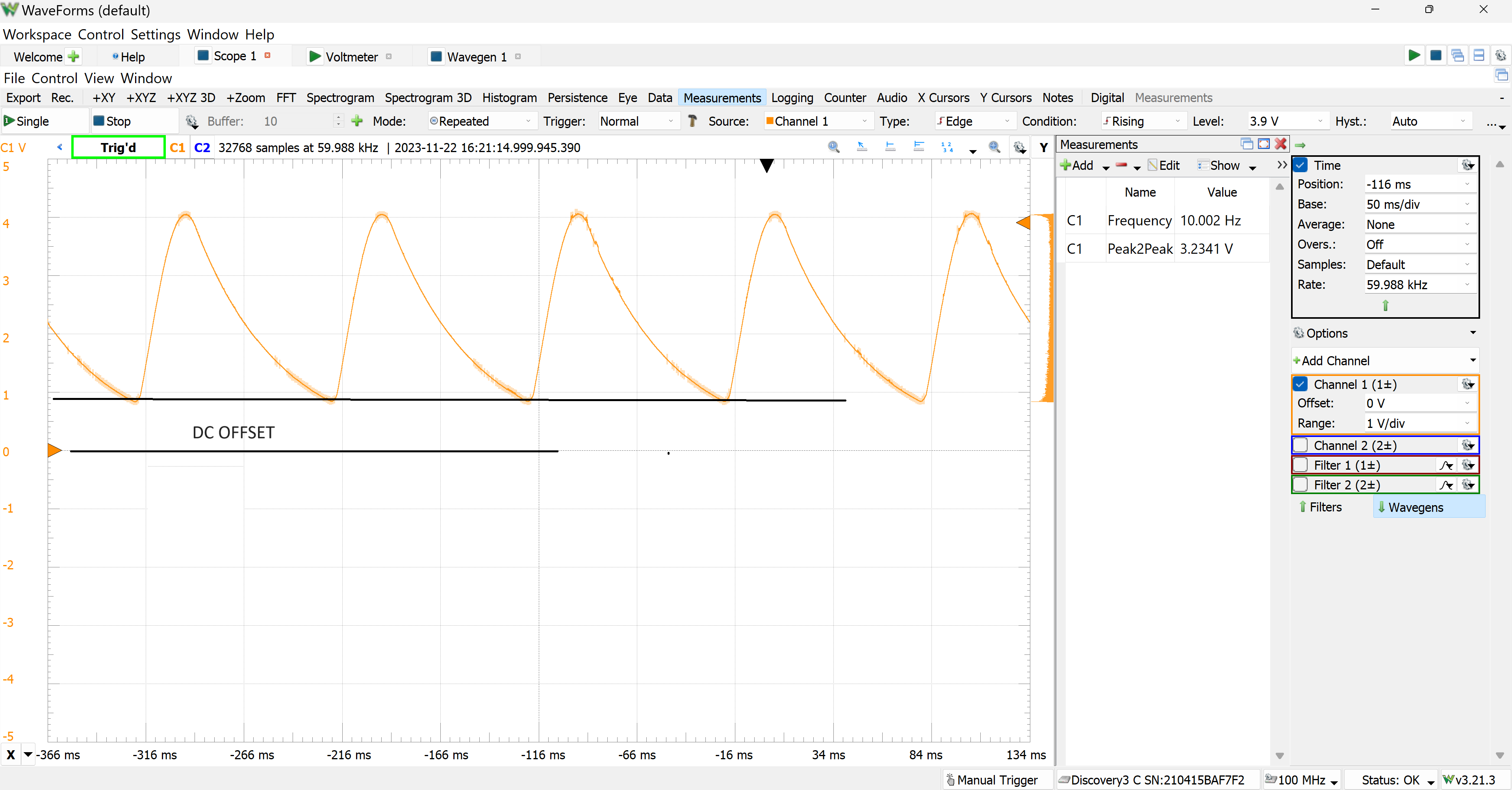

  • Hi Shiven,
    This is our test circuit below, and waveforms below that at 2, 10, 50 Hz input supply.
    As you can see, it is not switching correctly especially when the frequency is increased. We have tried many values of VCAP ranging from 2.2uF to 10nF without success (large DC offset above 10Hz).
    Does this mean that the LM74670 device cannot handle changes in input frequency?
    Our application has changing input supply frequency ...from 1Hz to 100Hz range. Is this device suitable?
  • Hi Peter
    The schematic looks okay to me.
    May I know the output capacitance and the load here?
    Looks like the output capacitance is charged here and there is very little load to discharge it when the FET is in OFF state due to which you see this Offset.
    Thanks and Regards
    Shiven Dhir

  • Hi Peter
    This device can handle changes in input frequency.
    If you test with low output capacitance or higher load the offset should reduce.
    Here output capacitance is not getting time to discharge and next cycle of sine wave charges it back because of which you see the offset.
    Thanks and Regards
