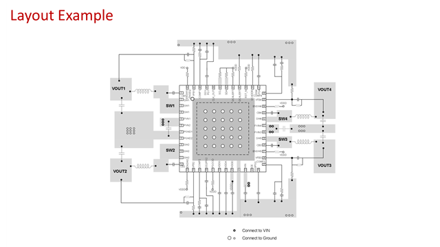

  • Hi Yaqi,
    Suggestions for you :

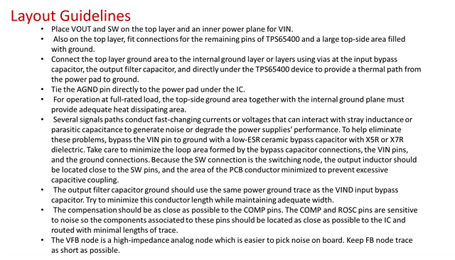

    1. Please pay careful attention to the datasheet and User's Guide.
    2. Please try to design according to the recommendations in the datasheet, including schematic , Layout example, and layout guidelines.
    3. After completing the first version of the design, communicate in time and I will review it .
    (Below pictures for your reference)
    Zhou

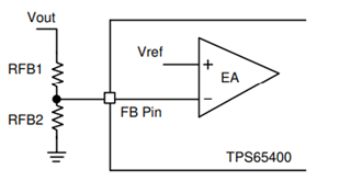

    2. How is the resistance value of the output voltage determined?

    2.Vout = Vref x (1 +RFB1/RFB2)        Default Vref in TPS65400 is 0.8 V
    TI recommends to use a 1% tolerance resistor or better one to get higher output voltage accuracy.
