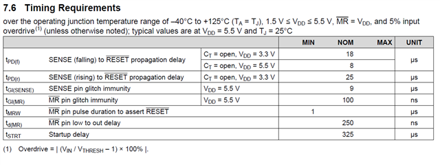

Hi team,
My customer want to know tPD(r) min/MAX value. In the datasheet there are only nominal value.
They want to calculate by using min/MAX value. Not NOM.
Youhei MIYAOKA
Hi team,
Youhei MIYAOKA
Hi Youhei,
tPD(r) min/max values are not specified for this device. No data is available.
