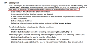

When over current protection happen, this will be log into life time collection right away or need some time to log into?

Section 10.1 in TRM lists all conditions for when lifetime will update.
The device does not write to lifetime every event when a protection trigger, this will wear out the data flash. It only writes to DF when a permanent fail happens. The remaining conditions are listed below.
