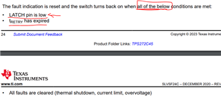

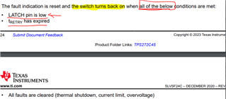

We are struggle to understand datasheet regarding Latch-off mode when LATCH pin is high.
From picture, a thermal shutdown appears and FLT is reset by simple toggling of EN pin.
However, in the datasheet is written like this
So as we are not changing polarity of LATCH pin (remains High) how the FLT indication disappear?

  • Hi Miroslav,
    Could you probe the LATCH pin to confirm voltage is greater than 2V?
    Could you also zoom into the secondary FLT assertion to see if output current is being drawn at a finer time scale?
    Elizabeth

  • Hi Miroslav,
    I just received confirmation, the FLT will go high as soon as EN goes low when LATCH is high.
    This is how we determine which channel is faulted when using version A of the device which has a single FLT pin.
    Elizabeth
  • Thanx Elizabeth,
    one last question. Is that aligned with the datasheet description?
    Miroslav
  • Hi Miroslav,
    I think the confusion here is the statement below:
    This statement is true when you consider the fault indication and switch turning back on as an ANDed result of the listed conditions (the fault indication is reset AND the switch turns back on) which I believe was the intention.
    However it is true the fault indication will be reset and the switch not turn back on under other conditions.
    We will work to make this more clear in the datasheet.
