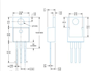

Could you tell me about the thermal pad layout for LM317T/NOPB.
I can not see it for NDE0003B.
https://www.ti.com/jp/lit/ml/mmsf014/mmsf014.pdf

Hi Josh,
You showed KCS, right?
https://www.ti.com/lit/ml/mpsf053a/mpsf053a.pdf
I need about NDE.
https://www.ti.com/lit/ml/mmsf014/mmsf014.pdf
They vary slightly in dimensions.
Does this mean that I can refer to KCS?

Hi Kengo,
You are correct that they vary, in terms of exact dimensions I wouldn't refer to KCS because you can see that they are different but in terms of design then you can refer to it.

Hi Kengo,
I have not been able to find exact dimensions for what you are looking for. I am asking more people for additional information. It is an older part, so I am trying to see if there is available information regarding this

Hello Kengo,
I have sent another note to the packaging engineer to get an answer on this. I'll hopefully have some feedback in the next day or two.
~ Aaron
Hello Kengo,
I got confirmation that the KCS landing pattern will work for the NDE package.
