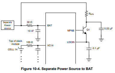

Hi expert,
Can LDOIN be powered by external buck?
LDOIN has 6V and 8V input voltage in NPN mode? Can I set external buck to always output 8V?
What about PSRR of internal LDO, can it stand the input ripple from buck?
Thanks!

Hi Jass,
To use an external power source, Figure 10-4 is recommended so that the internal circuitry can set LDOIN via NPNB and BAT. Batteries are very noisy so a buck converter being fed to Rnpn and the 30ohm resistor is not a problem as long as Rnpn is properly sized for the expected amount of current drawn by LDOIN.
David
