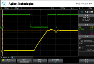

TPS552892-Q1: PG does not work properly and prompts that the output is abnormal.
Part Number: TPS552892-Q1
Other Parts Discussed in Thread: TPS552892
Hi team,
When the customer verified the board, the TPS552892 startup voltage had a downward pulse, and the voltage value was lower than 90% of the rated voltage, but the PG function was not triggered. Please help to check, thank you!
Green: PG signal
Yellow: TPS552892 output voltage

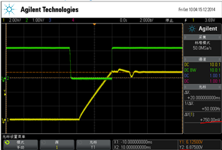

Verification will trigger on another board.
