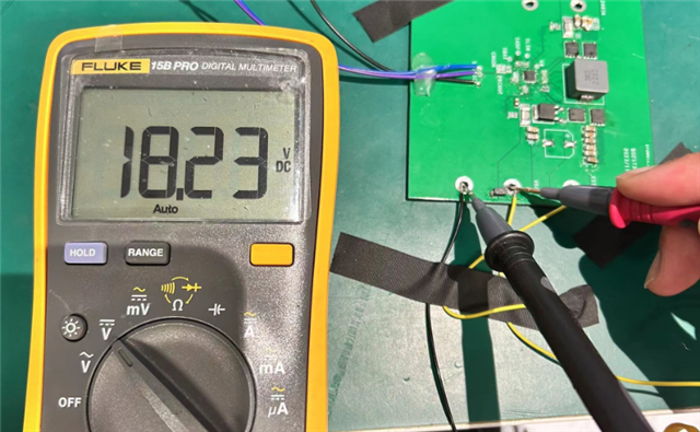

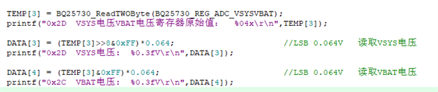

The customer test with BQ25730. Get the voltages of VSYS and VBAT through the 0x2D2C register. The original 16bit value obtained is: 9E9Ch.
According to the parameters in the specification, LSB: 0.064V, then VSYS and VBAT are 10.112V and 9.984V respectively, but the actual measured voltage is 18.23 V.
what else needs to be configured?

    The VSYS and VBAT ADC output rage is 2.88 V - 19.2 V for 1S-4S and 8.16V - 24.48 V for 5S battery as outlined in datasheet section 9.6.10. This means ADC has offset of 2.88 V(or 8.16 V). You need to add this offset to the ADC reading.
    9Eh x 64mV + 8.16V = 18.27V
