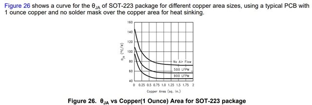

Can you please share Theta JA of LP3962EMP-2.5/NOPB?

For LP3962EMP-2.5/NOPB, the SOT-223 package's Theta JA numbers are mentioned in datasheet (Fig. 26):
As you see for 0.5 sq. in. area of copper the Theta JA is around 90 C/W.
Please review and let us know incase further details are needed.
