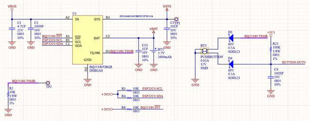

I developed a PCB using IC BQ25180.
The circuit used is in the image below. (VBUS is provide by USB)

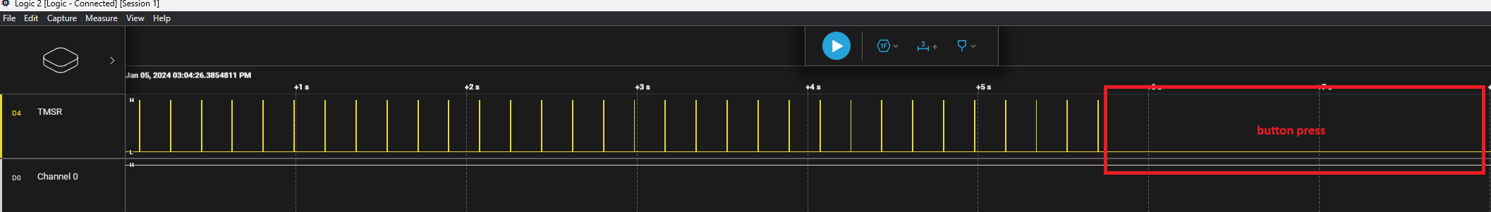

    Interesting, that function for `SetShipMode` looks correct. Are you able to provide some waveforms of the voltage at the TS/MR pin? It should have some pulses and pull to 0V when you press your push button.
    I'm also curious about your circuit that you've got on the TS/MR pin. Is that intended to signal to your ESP32 that the button is pressed? My suspicion is that this may be affecting the BQ25180's push detection.

  • I took the measure requested.
    However, to take the measurement I had to remove the pull-down resistor, as without it it was not possible to see the waveform.
    It is possible to notice that the signal became "LOW" when the button was pressed.
    The idea of having two diodes and a button is that they can ground two different signals without either influencing the other. The signal that is being grounded when the button is pressed is a general purpose button used on the platform.
    While the device is in ship mode there is no signal at "BUTTON.OUT0", as the "+3V3" source is not powered.

    The threshold for the button press is 90 mV. Do you have data on the TS/MR pin when the device is in ship mode and the button isn't pressed? It'd be great if you could measure it using the Salae (if that's a Salae) with the pin configured as an analog input instead of a digital one. Are you also able to measure the SYS voltage as an analog input as well?
    I'm expecting the TS/MR pin to be pulsing like you're showing when no push button is pressed and the device is in ship mode.
    Is it to feed the ESP32 a signal so that you can do other commands based on a push button? Or is this with the ESP32 pin configured as an output?
    After you've done the measurement I mentioned above, can you try the following if you're able:
    1. configure ESP32.OUT0 as an input with no pullup
    2. Remove D3, D4, R23
    3. Short the pads that D3, D4 were on so that BQ25180_TSMR = ESP32.OUT0 = voltage across the capacitor C4
    TSMR should clamp at 3.3V so this should not damage your ESP32 GPIO pin (if you're concerned on this, replace C4 with 55k resistor).
    Measurements would be good here of you can see if your code works now and shipmode can be exited with button press.
    My suspicion is that there's something in the behavior of the circuit that's not ideal with the push button detection routine on the BQ25180.
    I know that's a lot so let me know if there are any questions or if pictures are needed.
