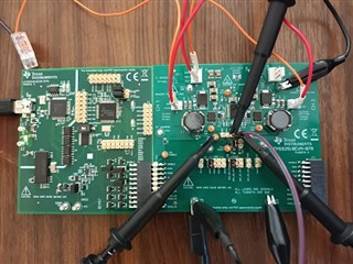

I am reaching out to you today to seek your assistance in the development of a product utilizing a custom-made electronic board based on an STM32 microcontroller, along with your LED driver (TPS92518).
My team and I recently acquired both development boards, LEDSPIMCUEVM-879 and TPS92518EVM-878, and have not attained the desired outcomes.
Here is our testing procedure:
    - Installation of the software provided with the development board (as per support's recommendation) on a Windows 10 computer.
    - Preparation of the development board (MCU + Driver) under a 48V power supply with oscilloscope monitoring.
    - Connection between the TI software and the development board --> Successful connection with visible SPI frame on the oscilloscope.
    - Attached is the configuration of our system calculated using your software.

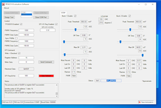

    - Definition of values in the driver registers (decimal):
       * CONTROL_value          = 31,    CONTROL_adress        = 0,
      * THERM_WARN_LMT_value   = 159,    THERM_WARN_LMT_adress    = 2,
       * LED1_PKTH_DAC_value    = 23,    LED1_PKTH_DAC_adress    = 3,
       * LED2_PKTH_DAC_value    = 23,    LED2_PKTH_DAC_adress    = 4,
       * LED1_TOFF_DAC_value    = 28,    LED1_TOFF_DAC_adress    = 5,
       * LED2_TOFF_DAC_value    = 28,    LED2_TOFF_DAC_adress     = 6,
       * LED1_MAXOFF_DAC_value  = 30,    LED1_MAXOFF_DAC_adress    = 7,
       * LED2_MAXOFF_DAC_value  = 30,    LED2_MAXOFF_DAC_adress    = 8,

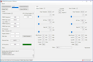

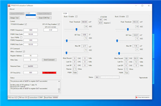

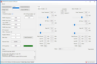

Upon activating both channels of the driver on the software, nothing happens. We have attempted to adjust parameters randomly available on the software, and at certain non-reproducible moments, channel 2 and then channel 1 lit up for a few seconds.
 Only channel 2 was lit up and we can see the "pwm" box set as "true"
 Only channel 1 was lit up and we can see the "pwm" box set as "false"
There are screenshots of these instances when the LEDs illuminated. These elements should provide a detailed insight into our current configuration and the issues we are facing. We believe that a more in-depth expertise from your team could be beneficial for overcoming the current situation.
