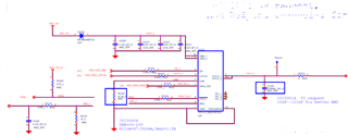

We will use TPS1HC30-Q1 as below chart, have any concern?
if any suggestion, Please advise me.

Hi Lawrence,
I noticed that the FAULT pin has a protection resistor after the pull up to 1.8V. It is better to put the protection resistor closer to the MCU since when FAULT pulls down, the MCU will now see a voltage division and not the expected 1.8V.
I also noticed that for best EMC performance, the customer is missing the 220nF capacitor from supply to system_GND.
Since there is no GND network, system_GND and IC_GND are the same node.
