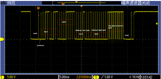

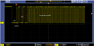

one issue need supporting as below. customer use BQ2026 in their project and meet below issues.
1. Read ROM: read 8 bytes ROM and get 0xFF for all bytes.
2. Read Memory: read a specificed address and get 0xFF back.
3. Write Memory: does customer must use 11.5~12V power supply for SDQ pin if they want write memory? does customer must release program pulse if they want write memory?
4. in customer schematic, the host is: STM32F031F4P6 and pin 13 of host was connected with SDQ pin. Vcc is 3.3V, pull up resistor is 5k.
