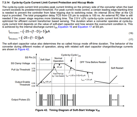

    I think you erratic behavior may be because you are hitting the over current hiccup mode protection.
    You can verify this by studying the Comp, CS, Transformer Input Voltage and you might as well look at Out E and Out F since you have an extra probe.  If the SS voltage is cycling during this most likely you are hitting over current hiccup mode.
    I would study these signals when the SRs are off steady state and when you turn them on.  This information will help you determine what is causing the erratic behavior.
