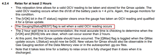

    Looking further into the log, I believe the reason this is occurring is that the [REST] bit is not being set after the charge, determining if a valid OCV measurement is being made even though VOK and RDIS are being cleared.
    I believe that when a valid OCV measurement is not being taken, one of these aspects is out of line:

    Thank you for sending, the ChemID chosen seems to be correct, seeing that ChemID 1892 has a DOD error of 1.21%.
    Looking again at the .log file, I believe this could still be occurring due to the voltage after the last charge being unstable while it should be in relax.

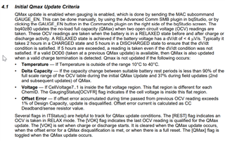

  • Hi Shuichi,
    Yes, however I have found something else that could be causing this issue.
    When the initial discharge begins, the VOK bit is never set. This could be effecting the process of the learning cycle. Please ensure that when the initial discharge begins, the VOK bit is set:

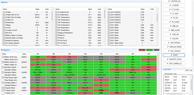

    I began the initial discharge with the following steps.
    1. Commands : FET_EN
    2. Commands : GAUGE_EN
     QEN=1, VOK=1
    3. Commands : RESET
     VOK=0, RDIS=1
    4. Discharge start
    Do I need to wait until VOK=1 after RESET?
    Best regards.
  • Hi Shuichi,
    Yes, after the reset is done, please ensure that the charge and discharge FETs are still enabled from the FET_EN, since VOK is set when a charge or discharge is observed. Below has the process of the first discharge and when these bits are supposed to be set and cleared.
