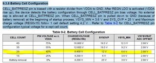

    1. The CELL_BATPRESZ voltage depends on your battery. Please refer to datasheet section 9.3.7. Additionally, there is a schematic checklist in this link here.

  • Hi MD,
    1. Due to customer needs, it may happen that the 2S battery is used or the battery is removed.
    Could we always set CELL_BATPRESZ to 2S? Is there any problem with removing the battery in this condition?

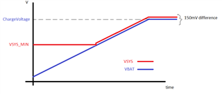

             When VSYS_MIN > VBAT;VSYS = VSYS_MIN。
             When VSYS_MIN < VBAT ; VSYS will be dynamically adjusted with VBAT (VSYS=VBAT). Is this correct?
    4. May I ask about the relationship between Charger voltage and VSYS_Min and VSYS?
    Under what conditions is VSYS=VSYS MIN used?
    Under what conditions is VSYS=CHARGER VOLTAGE used?

  • Hi Steve,
    1. If you plan to use different battery configuration for example 2S or 3S then it is best to set the CELL_BATPRESZ to the highest battery setting (in this case 3S) and adjust ChargeVoltage register to appropriate value when 2S battery is used. If battery is removed then CELL_BATPRESZ should be pulled down to ground to indicated battery removal to the charger.

    your understanding is correct on VSYS being dynamically adjusted with VBAT (VSYS=VBAT). However, it should be noted that VSYS is not exactly equal to VBAT but nearly equal. VSYS sits about 150mV above VBAT.
    4. Refer to the following plot.
    Munir
  • Hi MD,
    1.How should we set the battery configuration for customers to use 2S or remove the battery?
    Plan to set CELL_BATPRESZ to 2S when the battery is removed.
    At this time, VSYS_MIN=6.6V, CHARGER VOLTAGE=8.4V. Will this cause any problems?

  • Hi Steve,
    1. It is best to pull CELL_BATPRESZ  to ground when battery is removed in order to let the charger adjust its operation.

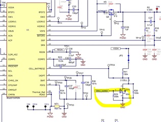

  • Hi MD,
    1.We plan to refer to the design of the development board and add Q12 to determine whether the CELL_BATP setting is a 2S battery or to remove the battery.
    Are there any problems with this solution? (CELL_CTRL=HI, CELL_BATP=Remove battery; CELL_CTRL=LO, CELL_BATP=2S battery).

  • Hi Steve,
    1. Q12 looks good. The EVM also uses the same solution.
