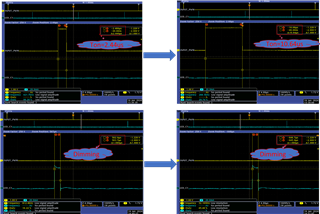

LP8864-Q1: LP8864-Q1 dimming can't response when input PWM on-time change time more than 6.4us
Part Number: LP8864-Q1
Hello  TI Team,
LP8864-Q1 is set in Phase-shift PWM mode and the input PWM frequency is 211Hz.
When doing below operation, the dimming on-time doesn't change:
The input PWM on-time had met the PWM detector hysteresis requirement, but the dimming still didn't change.
Could you confirm the issue?
