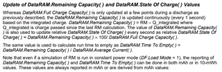

    I believe the main issue of this is that if you are constantly either charging or discharging the cell for long periods of time, there is not enough time of the cell relaxed for an accurate OCV reading to take place and gauge where the SOC at that point truly is. To constantly charge and discharge without a relax period will cause error to build up, due to the coulomb counting measurements not having the time to clear and readjust.
    Regarding the first question asked, I cannot estimate how the gauge will continue to act if this process will continue without more information or a log of this data. Below is how the SOC is calculated and where the updates of the RM and FCC that are used in that calculation occur.
    Regarding the second question, I believe including some sort of relax time between the constant changing from charge to discharge will allow for the SOC to adjust to its normal measurement.
