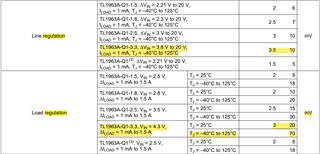

    Also, I have few other questions about output voltage accuracy of  TPS73801. In TI website it says its 3%. I believe this accuracy would cover entire  temperatue range and full load current of 1.5A. But my requirement is, I need to maintain 2% tolernance for an 5V output at 100mA load current for full operating range of -40 to +125C. Would it be possible to achieve with both the TPS73801 &TL1963A-Q1 ICs ? do you have some data which can support this?
    I have a similar question regarding Load regulation as well. I believe the data given in the datasheet is for 1.5A load current ? do you know whats the load regulation at 100mA load current for 5V output ?
    Are there any parameters that i need to consider while estimating the output voltage accuracy of this LDO along with Line and Load regulation ? All i need to know whether this LDO can meet my requirement of 5V at 100mA load current for full operating range of -40C to +125C.
    Manoj.
  • Hi Manoj,
    I would expect your load regulation to improve if your load is just 100mA for these higher current devices, however we do not have any test data published in the datasheet to help guide us on what improvements we would see.  The parameters you should consider in your DC tolerance assessment are: load regulation, line regulation, reference voltage tolerance, and feedback resistor tolerance.
