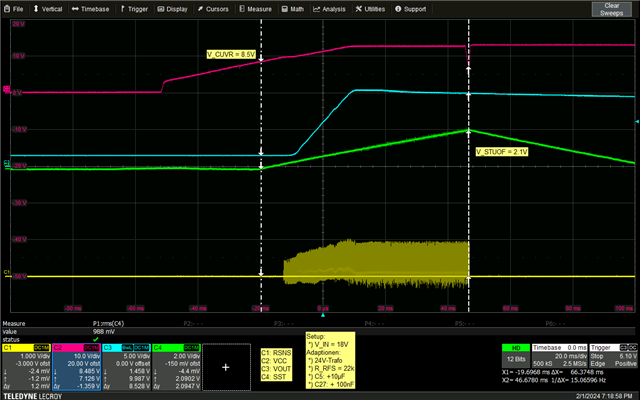

Testing is done via the external adapter and VIN = 18V. However, the TPS23758 seems to have a problem with the reduced primary inductance (changed vom 150µH original to 65µH in the adaption). The output regulates to about 10.5V, the voltage on the FB-Pin is 0.75V instead of 1.75V. Increasing the switching frequency up to 680kHz did not change the behaviour of the circuit. The converter goes in a kind of makro on/off state which depends on the startup timing (CSS capacitor).
Please note the attached image:
Converter starts switching, and the output rises. The voltage on the FB pin is around 0.75V (not shown) and stays there during the switching period (C1 on). This continues until SST reaches its termination value of 2.1V which forces the bootstrap startup current source to stop and therefore the output voltage to begin to reduce.
Changing the input voltage away from 18V towards higher voltages reduces the output voltage.

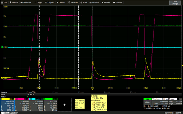

Also note the detailed waveforms in the following image (changed rise time of FET via SRR resistor).
The converter shows some starnge behaviour every second cycle, which is always shorter (maybe overcurrent error?)

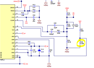

    I am wondering if you also changed the APD's voltage divider resistance. You may need APD = H to enable the dc/dc converter operating at a lower input voltage.
    When using a 18-V adapter, APD is 18V/(200k+9.09k) = 0.78V. You may need to change the R25 to 20k to make sure APD is higher than 1.58V.

    D8 & Q1 and snubber: I think 26-V rated D8 is not enough. The secondary FET drain-source voltage will be Vout + Vpri/N_p*N_s + overshoot = 24-V + 57V/1.2*1 + overshoot. Which will be much higher than the 5-V case. If the voltage rating is too low, it may cause the over current issue like the large CS voltage.
    R_SRR 10->120 Ohm: it may be a risk. Considering you have FET on the secondary side and a high turn-off resistance may cause longer shoot-though time which may trigger an overcurrent event.
    R_FRS 60.4->22k Ohm: increasing the switching frequency will cause increased switching loss and temperature rise on the chip.
