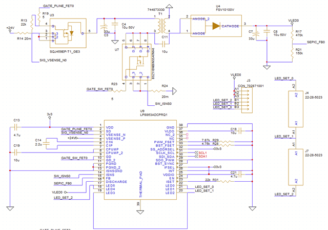

I am attempting to drive an LED string at near 900mA using the LP8863 in the following setup:
  • SEPIC mode with 24V input and 23.2V max output with RFB1=150k and RFB2=470k.
  • 400 kHz switching frequency
  • 33uH coupled inductor, 10uF coupling capacitor, 33uF polymer + 10uF ceramic capacitors on input and output.
  • 141mA current limit per channel (Riset = 22k)
  • All 6 channels are connected in parallel.
  • Control through I2C

    could you pls share the schematic?
  • Hi Zhiqian,
    This is the schematic being used. Jumpers are place on J4 and J7.
    Thank you

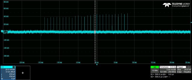

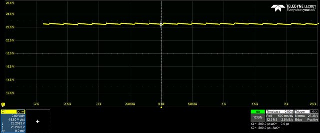

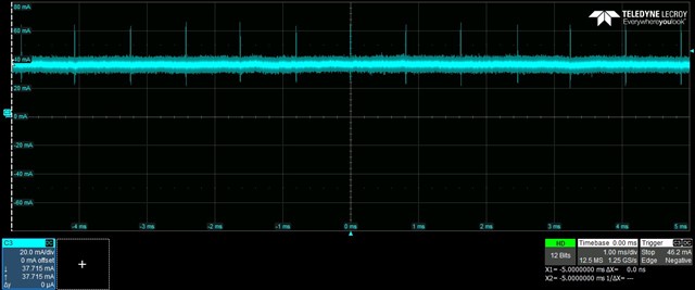

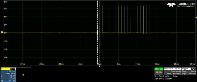

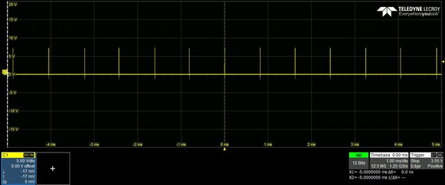

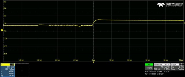

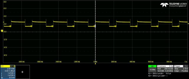

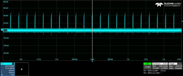

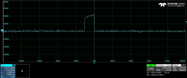

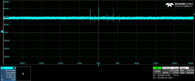

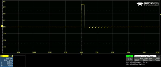

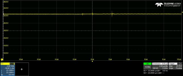

  • Hi Zhiqian, here are waveforms at two different current settings. The first set is with 0x80 written to all LEDx_CURRENT registers. The second is with 0xA0 written. There are several timescales to show the behavior fully. All waveforms are with PWM set at 0xFFF (100% duty cycle). Thank you for your help.
    LED current waveforms at LEDx_CURRENT = 0x80:
    FB pin waveforms at LEDx_CURRENT = 0x80:
    VOUT waveforms at LEDx_CURRENT = 0x80:
    GD waveforms at LEDx_CURRENT = 0x80:
    LED current waveforms at LEDx_CURRENT = 0xA0:
    FB pin waveforms at LEDx_CURRENT = 0xA0:
    VOUT waveforms at LEDx_CURRENT = 0xA0:
    GD waveforms at LEDx_CURRENT = 0xA0:
    Depending on the waveform, the close loop is unstable, could you pls try to change the ratio of FB and add the output cap to have a try?

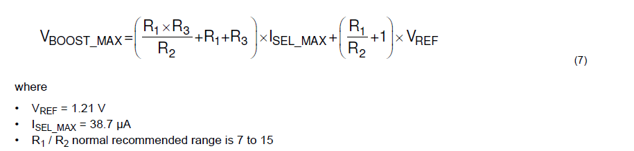

    Thank you for the suggestion! Do you suggest changing the FB resistors to higher or lower resistance? I also notice the FB pin is not regulating to 1.21V as the datasheet suggests it should. Will increasing the value of both FB resistors help this? I have tried adding additional capacitance (an additional 33uF polymer + 10uF ceramic) with the same issue.
    For our device, the ratio of FB pin is recommend in the datasheet, pls also calculate the boost output range if it can match the LED requirement.

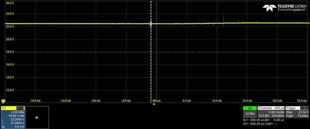

    Here are waveforms of voltage across the LEDs and the headroom voltage. We are trying to drive the LEDs between a minimum of 13V and a maximum of 24V. I have tried replacing the part with a new IC but the issue persists. Do you have any thoughts based on these waveforms?
    LED Voltage:
    Headroom Voltage:
    Thank you,
    Vikesh
  • Hi, Vikesh
    As mentioned, could you pls changed the divide ratio of R1/R2 in the datasheet? increase the ratio to 7~15
