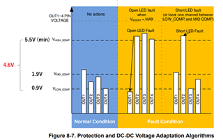

Hello team,
I have connected 8 LEDs on OUT1 -> no problem
I have connected 9 LEDs on OUT2 -> no problem
I have connected 8LEDs on OUT1 and 9LEDs on OUT2 @ PWM Duty 100% -> device output FLT signal.
The VBoost was 33V.
The voltage at OUT1 and OUT2 were all withing the 0.9V - 5.5V range, so they were within the VLOW_COMP to VHIGH_COMP range.
Do you have any idea why does EVM not work for different LED numbers on 2 ports?
