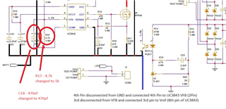

We removed R16 and added 10K resistor in series with the capacitor. still we see the same issue.
No load condition 10 ~ 12V oscillating
Load condition, voltage down to 4 - 6V
Note : AUX voltage designed for 16V but getting 8-10V from begining
Did you try add some load at your converter output to see if you can get AUX voltage to close 16V?
Also can you try to did connect D11 and use an external power supply to bias VCC to see if your converter output can have about 12V?
Another thing noticed is R9 should connect to the intersection of D12 and D11 you can try this.

3. Yes I changed connection in Hardware to connect to the intersection of D12 and D11

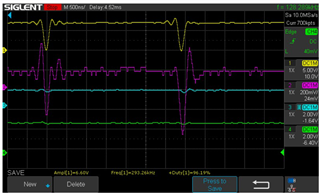

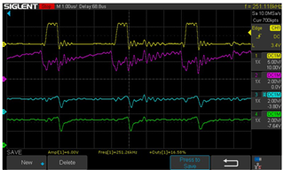

Now we added 120 ohms (10W) load resistor and below modifications. Now output voltage is 0V at 150V input. Auxiliary voltage is stable at 8V. Please check and advise
If we increase up to 200V input, AUX voltage still remains same 8V
output voltage 2V
Please provide the OUT pin waveform along with the waveform of ISENSE, RT/CT, FB and COMP when AUX is stable at 8 V.
Please check shared waveforms
1 - OUT
2 - I_Sense
3 - V_FB
4 - Comp
1 - OUT
2 - RT_CT
3 - V_FB
4 - Comp
CS (purple) reached over 1V to terminate the pulse so the current sense resistor value needs to be smaller.

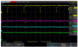

Current Sense Resistor changed 0.22E to 0.1E. Now the MOSFET is turned on completely after applying more than 30V making fuse Blow (Now added 5A fuse).
Waveform captured is at 30V input
1 - OUT
2 - I_Sense
3 - V_FB
4 - Comp
Please retake the waveforms but change I_sense oscilloscope vertical scale to 0.1V/div.
The OUT shows full duty is because FB < 2.5V.
You need to build your converter based on your design. So you should use a transformer that can meet your design target.

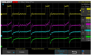

Below shared waveform 0.2V/div (we couldn't capture 0.1V/div - it's beyond screen)
1 - OUT
2 - I_Sense
3 - V_FB
4 - Comp
When OUT is high ISENSE should keep rising. But your waveform ISENSE did not. So it looks your circuit had something not correctly wired. You need to find why ISENSE did not keep rising during the time when OUT is high.
