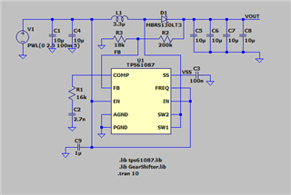

I can't get the Spice model for TPS61087 to work on LTSpice. I'm only using the circuit showed in product's datasheet. Could anyone be able to help me?

Hi Calos,
To transfer a model from PSpice to LTSpice, you need the netlist file (.lib) of the model. This file is within the PSpice model folder that is downloaded from the according product page.
Once you have an unencrypted netlist file, they can transferred the netlist to their simulator of choice.
We do not provide any automated tools for that, so this transfer process is already be performed by the customer themselves.
The new netlist and according to symbol can be directly used in their LTSpice circuit.
Please note the disclaimer:
We only provide support for our PSpice models. Once they transferred the model to LTSpice or another simulator, we cannot help in debugging anymore.
However, there is one helpful e2e thread that addresses common errors that occur during the transfer process:
