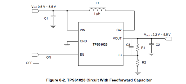

Is there a inductor L1 value design method or value VS output current table for reference?
If I select a 2.2uH inductor, how much the rated output currrent?
Thanks.

if I need 1.5A rated output current, how much inductor saturation current at least?
Thanks.
Hi Chambin,
Please read datasheet 8.2.2.2 Inductor Selection for guidance.
Travis
Hi Travis,
if I need 1.5A rated output current, how much inductor saturation current and DC current at least?
Hi Travis,
Our input range is 2.3-3.3V, Output voltage is 5V/1.5A .
Could you recommend proper inductor parameters?
Thanks.
Hi Chambin,
The critical value is around 4.2A. So I recommend 5A for some margin.
