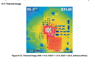

i want to know what's The conditions of this  experimental tests of TPS56221 eval bord
(was the card oriented vertically or horizontally? the card was on a wooden or plastic table or other material, environment and surrounding.
and thanks
    As for the test conditions for the TPS56221 thermal image, the IC was oriented horizontally. The board was held by a circuit board holder to keep it in place and away from any objects that could damage the device. It was mounted on plastic. The board was tested in the lab and measured at room temperature (ambient temp). (VIN = 14 V, VOUT = 1.0 V, IOUT = 25 A) are the test conditions and the device was turned on in this condition and held for a 10 minute soak time before the image was taken.
    Hope this helps.
