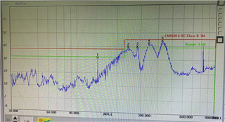

  We use the LMR51420 to generate a 5V voltage, the input capacitor is 22uF, the output capacitor 22uF. while the Inductor is 4.7uH.
when we do EMI radiation test, we found that EMI value more than limit, after we debug several times, we still can't pass. the layout followed the suggestion on the datasheet.
Whether anybody had this kind of issue before? thanks

  • Thanks Marshall,
     LMR51420YFDDCR & LMR51420YDDCR have almost same result.
    to simplify the testing, only the 5V voltage generate circuit soldered.
    the wave point 2,3,4,5 is highest, mainly around 300Mhz,
    there are still exist even increase the input capacitor and output capacitor.

    3. scan;

    I agree, your schematic and layout look good.
    The radiated scan you are sharing appears to show a spike at a frequency which the switch node usually rings at.
    There are a few things you can try doing to see if it can improve.
    1. Is L4 a fully shielded inductor?
      1. If not, I recommend choosing a shield inductor like coilcraft xgl series.
    2. You can slow the slew on the HSFET gate drive by placing a resistance in series with C3 and pin6.
      1. Start with 10ohms
    3. The SW node ring can have a snubber installed to damp the resonant ring
      1. Start with R=a couple ohm, C=22p
