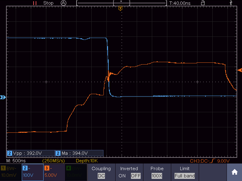

While testing a 2.5kW PSFB design, it is successfully working and giving expected 48V output at 10% load (5.3 A). But as the load is increased to around 8-9A, MOSFETs B and C are getting damaged (all legs shorted). Thus, shorting the input.
Visible burn marks can be seen on the thermal tape of the heat sinks of AB leg. (Indicating B is getting more heated compared to C which was also shorted but had no burn marks on the thermal tape of heatsink).
MOSFETs A and D were fine.
As expected MOSFETs A and B are not operating at ZVS at 10% load, unlike CD leg which is operating at ZVS and is comparatively less heated.
Blue: Vds of MOSFET B;
Orange: Vgs of MOSFET B

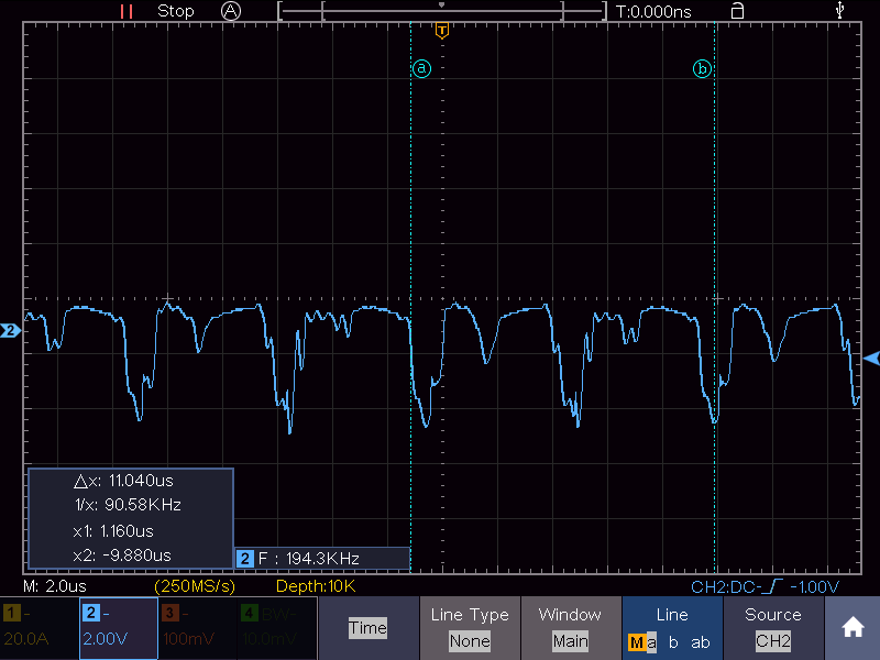

    All the below waveforms are at 10% Loading (CR) (5A) (Input Voltage: 400V)
    The CS pin waveform is probed. The waveform does not resemble the one given in application note of UCC28950.
    Fig. Waveform at CS pin.
    The waveform at the secondary terminals of Current Sense Transformer is given below.
    Fig. Waveform on the Secondary terminals of Current Sense Transformer.

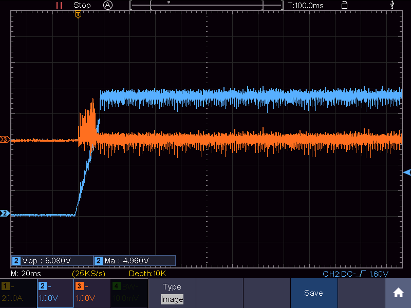

    Occasionally at the start-up, audible ticking noise can be heard from the board (When the output voltage is being built-up). This is due to Hiccup Mode and is verified by probing on SS pin. Once output is at steady-state, there is no noise.
    Fig. SS pin Waveform at start-up.
    Other times, the soft start is working properly.
    Fig: Waveform of CS pin and SS pin at Start-up at 5A (10% loading)
    Blue: SS pin Waveform
    Orange: CS pin waveform.

    If your SR FETs are failing.  They are failing due to over current/over voltage and or over temperature.
    I agree that your current sense signal does not look correct.  It also should not be going above and below ground.
    If you are not measuring the primary current correctly with the current sense transformer you will not be able to protect the design and FETs.
    So the first thing you need to do is to figure out why your CS signal does not look correct and fix this.
