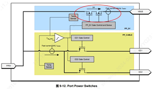

  • Customer: How to proactively shut down the PP5V power path? Thank you.
    TI: What do you mean by proactively shut down the PP5V power path? In what cases/situations would you need to do this? I do not think we have a simple control mechanism to disable/enable the PP5V path. It is controlled by the firmware during normal operation.

  • Hi Chris
    We want to prohibit reverse charging in low battery or long endurance mode, so we need to achieve this by turning off the charge OTG and PP5V path.Now we can disable Charge OTG, but PP5V still provides a reverse charging path

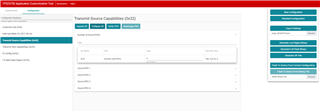

  • Hi hui,
    2. When PD25750 is the source, we support two types of PDO: 5V/3A and 9V/3A
    Did you send the correct project? The one you sent has 15V and 20V PDOs

    2. Did you send the correct project? The one you sent has 15V and 20V PDOs
    We have sent the correct project and set the PDO num to 2 according to the project requirements.

  • Hi Hui,
    The jmgo_20240418.json that was sent earlier does not appear to have the settings mentioned. If I do not have the correct json, please share the latest one.

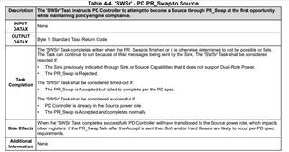

    1: The TRM describes information on why a task return statement may be rejected. Do you know if the far-end device is DRP and can swap to Sink? That could be a reason for the rejection.
    2: I'm not sure what you mean by "set the sink and source mode". But looking at your project, the TPS25750 is configured to be DRP so should be able to complete the 'SWSr' command. Can you share the I2C log of the SWSr execution?
    3: Even if you complete the SWSr command, your device is configured to be "preferred power role Power Sink". When this answer is selected, the TPS25750 will always try to send a PR Swap request to the far end device when the TPS25750 is configured as Source.
