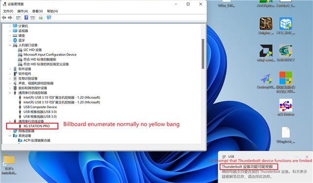

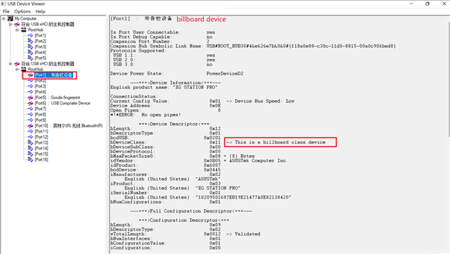

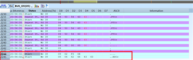

I use TPS65987DDJ+TPS65982BB for TBT3 device design,our circuit is follow intel reference design Tapex Creek TI88
and I build PD FW by GUI 6.3.6 with extend billboard binary(setting for billboard binary all default,no any change),then merge PD FW with TR FW
but TPS65982BB works abnormal,and cant see billboard device on host when connected our TBT3 device to host.
Does PD FW comprise billboard FW if I chose extend billboard binary to yes?then billboard can load FW from PD?or do you have any other suggestions for this issue?
