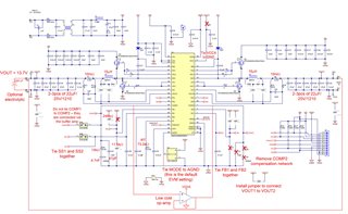

  • Hi Shinji-san,
    MODE is only checked at startup, not changeable on the fly.
    See below as an alternative with MODE tied low. This schematic actually shows the EVM changes to make a 2-phase design (in this case Vout is 13.8V).
    Tim
  • Hi Tim-san,
    If you connect MODE to AGND, then the device will act as single phase dual out correct?
    Does this schematic mean, disconnecting FB2 loop and insert Channel 1 FB loop to COMP2 through buffer amp, correct?
    Does internal error amp channel2 affect the operation?
    Could you advise how to enter standby mode?
    regards,
  • MODE to GND configures the IC as a dual-output, where the controller can enter ultra-low quiescent current mode for optimized light-load efficiency. Then we "force" it to operate in 2-phase single-ouotput mode by allowing COMP1 to drive COMP2.
