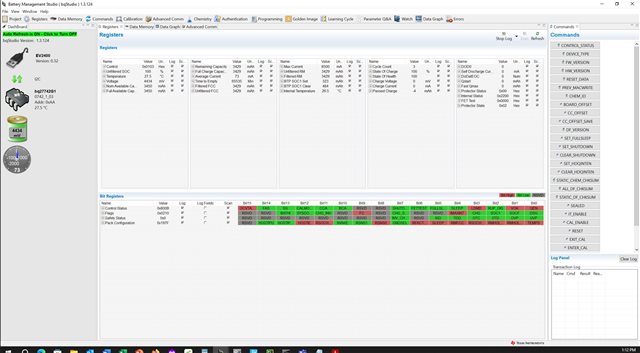

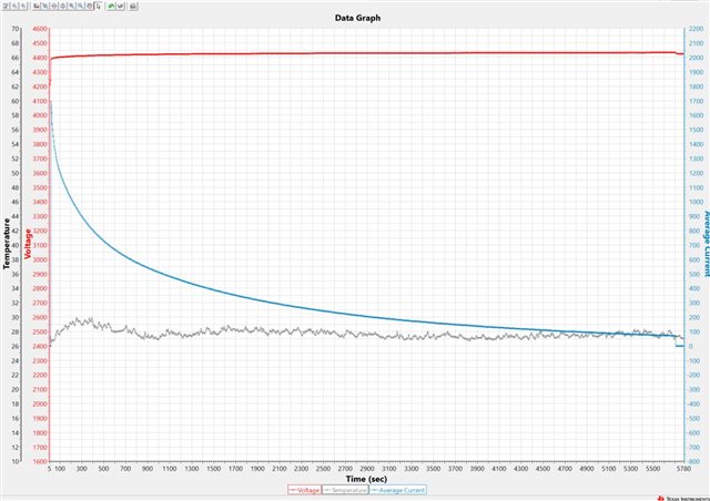

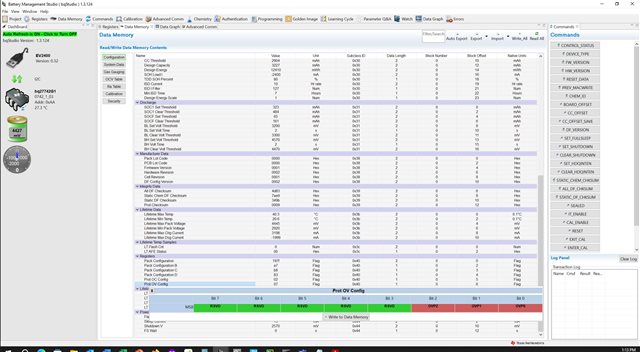

    There is another charge termination issue that I am trying to solve and I hope to hear your suggestions too.
    I try to charge battery till the charging current less than 64 mA (taper current of battery DS). According to BQ25890 DS 9.2.7.1 & 9.2.7.3 'The charger device automatically terminates the charging cycle when the charging current is below termination threshold', I have set Termination Current Limit' to 64 mA(Reg05 =00 ), However, the BQ25890 charger always terminated around 200 mA charge current when Battery Voltage stabilize(4445 mV) for around 200 seconds.
    I would appreciated it if you could let me know how to achieve '9.2.7.3 Charging Termination' below 64 mA taper current. I attached BQ25890 Reg settings and test data as below for your reference.
    Thanks & regards
    Robert

  • Hi Robert,
    Please see my comments below.
    Firstly, there will be some part to part variation on termination current accuracy, but I would still expect to see termination occur at a lower charge current than 200mA with the 64mA setting. Is the reported behavior consistent from one IC to another? Or have you only tested with one board up to this point.
    I have captured the below waveform using the BQ25890EVM and a battery simulator. I configured register settings to the same values as you provided. As you can see termination occurs very close to 64mA. How are you measuring charge current? In the attached test data "AvgCurrent" appears to reduce from 229mA to 11mA before termination occurs.
    Garrett

    Actually, your comments have finally guided me found the root causes. My BQ25890 Charge Voltage setting 4.448v (Reg06_2-7) too close to BQ27742 Prot OV Config setting 07(4.45V max) which have caused BQ27742 reg0x0078 change to 10 and disconnect CHGFET.
    The charger have terminated at 54 mA after I changed charge voltage to 4.432v and added IR Compensation Resistor/ IR Comp Voltage Clamp.
    I would appreciate it if you could provide more details about the relationship(calculation formula) between IR Compensation Resistor/ IR Comp Voltage Clamp to charge voltage setting(BQ25890 Reg06) and Battery Voltage(BQ25890 Reg0E).
    Attached test data as below for your reference.
    Thank you.
    Robert
    BQ25890_ip13_No1_LC_4445_chemID3520_240424b.log
