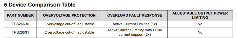

My customer considers TPS2663 for their next project.
And They have a question about the difference between TPS26630 and TPS26631.
In the table above, the difference is overload fault response.
1. Can TPS26631 support under 2*I_ol current during 25.5msec if the load current exceeds I_ol?
And the current is over 2*I_ol during 25.5sec, TPS266131 is shut down. Am I right?
2. What is the advantage of TPS26631 regarding on the function of 2x active current limiting during 25.5msec?

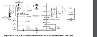

3. I see that both TPS26630 and TPS26631 can support reverse voltage protection and reverse current protection. Am I right?
And Should I add other parts for input pin for use these 2 functions?

  • Please see response inline:
    1.
    Can TPS26631 support under 2*I_ol current during 25.5msec if the load current exceeds I_ol? Yes
    And the current is over 2*I_ol during 25.5sec, TPS266131 is shut down. Am I right? Yes
    2. Pulse current support allow device to pass transient current above system DC current . Some applications need that.
     3. I see that both TPS26630 and TPS26631 can support reverse voltage protection and reverse current protection. Am I right? Yes
    And Should I add other parts for input pin for use these 2 functions?  Yes. Please see below from datasheet application section. You can refer EVM design also.
