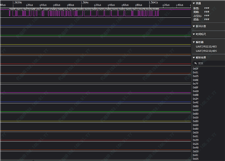

  We used GPIO(MAIN_ADC) for insulation detection and found that when the input voltage to GPIO8 is less than 0.045V, the data returned by channel 8 is always 0.045V(The number returned is 0X129), but when the voltage is greater than 0.045V, the voltage value collected is normal , The resolution used is 152.59 uv/LSB .
  My Problem is My question is how can I collect voltage values less than 0.045V,Are there any configuration items required for the GPIO port of the MAIN_ADC to capture values below 0.045V

    Thank you for your letter , The resistors we use are as follows
     R1 = 2.09MΩ , R2 = 2.09MΩ  R3 = 14KΩ , R4 = 15KΩ
    We tried to configure it as 0b110, and the collected value was about 0.7V. For 0b010 and 0b111, the result is 0.045V
  • May I ask why the voltage collected after I pull down the GPIO port to the ground is still 45mv instead of 0V
  • The 45 mV is most likely due to the R1 and R2 resistors being large. As mentioned in the table in the Insulation Measurement section, if R2, R3, and R4 are too large, there can be inaccuracy due to leakage at ADC pins.
