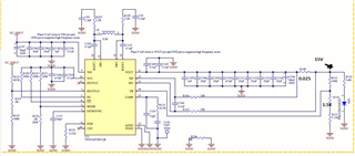

Team, Below is the Schematic.

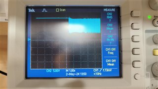

Scenario 2: When the load @Full load (1.22A) is connected, and then Vin is applied, the output is observed with Oscillations as seen in image below.
I Updated CC ( C118) to 10nF, Able to maintain regulation upto 0.5A.

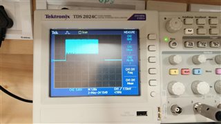

Scenario 2: @Full load (1.22A), Even after 1 second, doesn't maintain regulation, Below Oscillations are observed.

    It looks like the stability problem.
    1. Can you share the input voltage and max output current?
    2. What is the part number of the output capacitors(C108-C114, C106), and it seems C106 is floating, the COMP parameters will also differ. We need the ESR and effective capacitance to calculate the COMP parameters. You can also use the attached Calculation tool for that.
