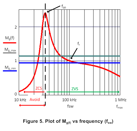

    The UCC256404 has zero current switching avoidance to prevent the design from latching up.
    This will force the frequency to only operate above the LLC peak gain that occurs at fpp in the normalized gain curve for an LLC below.  This curve came from application note slua923.  The following link will get you to the application note and describes this gain curve in more detail.   https://www.ti.com/lit/an/slua923/slua923.pdf

    When you mean capped, I believe you mean the frequency will not go any lower than 60 kHz.   When your output is low the converter will lower the frequency to increase the gain to try to maintain the output voltage.  However, if the designs primary starts to ZCS on the primary, the LLC controller will not allow the frequency to go below fpp.  This will look like a frequency clamp.  I  believe this is what you observing.
    The ZCS avoidance is explained in detail in application note SLUA923.  Please note when the output voltage low is low the LLC will decrease the frequency to increase the gain.  Please note the frequency will not go an lower than fpp.  When the output voltage is high the converter will increase the frequency to decrease the gain.
    When you are testing your design at 180 V this is lower than your typical input range.  The design is decreasing the frequency to increase the gain.  However, your design can't achieve the output voltage so the loop will force the frequency to fpp.  It will look like it is clamped.  However, the loop is saturated because the output voltage can not be achieved at that low input voltage.  I believe this is what you are seeing.
