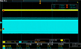

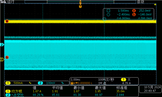

       Hello, I am using TPS621351. The FB I set is 0.298V, and the feedback adopts < Different Methods of using TPS63xxx step-up converter to drive LED > Article 4 and Point 4 to improve the LED current control accuracy, but I find that my input voltage fluctuates, and the output current also changes. When the input voltage is below 11.14V, the output current is 1.85A and begins to drop. My test environment is TPS621351 SS pin connected to 120K resistance pull-down, VFB is set to 0.298V, R1 uses 953K, R2 uses 80.6K, and the sampling resistance is R150. My DAC is a 0-3.3 PWM signal, and the PWM is input to R1 through RC filtering (1uF+1K). I tried replacing the resistor, and the result was the same. When the input voltage falls below 11.14V, the output current begins to fluctuate less. I suspect it's a duty cycle problem. I set the MODE of the TPS621351 to low with no forced PWM.
