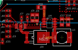

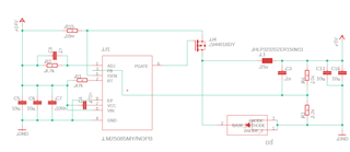

You can find attached the schematics and layout of the supply.

    It looks like you are using a VSSOP package device from the PCB layout IC footprint.
    Most of the thermals go through the power planes (VIN, VOUT, and GND). In the PCB layout the GND looks like a simple small trace which will greatly bottleneck thermals.

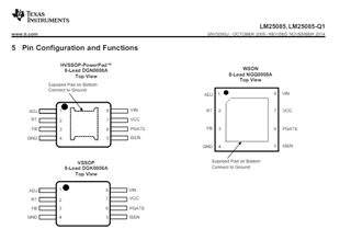

    It is also mentioned in the datasheet that:
    As such I would suggest using the HVSSOP or WSON package since the exposed GND pads will definitely help lower the heat dissipation of the system.
    The HVSSOP should be a direct drop in replacement, you will need to make sure the top layer where the IC is soldered has a large GND plane to help with thermal dissipation.

  • Hi Jimmy,
    thanks for your answer. It's a two layer PCB and the bottom layer is the ground plane. There is a via directly next to the IC's ground pad.
    I do not need to be able to dissipate more heat as stated in the datasheet, I need to eliminate heat dissipation because the efficiency now is ridiculously low. It has to do with irregular switching behavior. I don't observe a clean square wave, instead, there are multiple irregular spikes within a period.

  • Hello Oscar,
    How much output capacitance do you have on the 5V output rail? It looks like you only have 2 x 10uF and depending on the voltage derating, it will be less than expected.
    Have you tried increasing the output capacitance? I'd suggest adding another 2 x 10uF and retest for stability, since you mentioned the switching behavior is not clean square wave.
