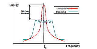

  • Hi GBDH,
    Spread spectrum and FPWM/PFM aren't mutually exclusive. You can still modulate the frequency between a couple of Hz with both modes.
    Andrew

  • Hi GBDH,
    The device doesn't have spread spectrum unless there's an S in the p/n. Ex:
    LMR38020FSDDAR
    LMR38020SDDA- Spread spectrum with PFM mode switching
    LMR38020FDDAR- FPWM with no spread spectrum enabled.
    Andrew

  • Hi GBDH,
    That is correct. The version with the S in the suffix is also a version lacking the F, so it has a PFM mode in light load, and uses the spread spectrum feature to oscillate the switching frequency on top of the PFM effect. At full loads, it goes to an FPWM mode, same as the F device.
    For your application I recommend the F device or FS device. Both will have the FPWM mode enabled.
