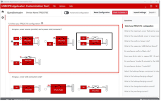

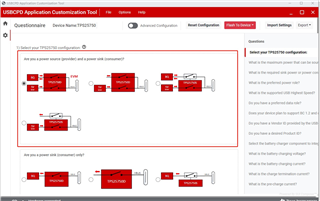

My customers are trying to develop TPS25750 pairing with BQ25713, Here they have some problems when using TPS25750 and the GUI tools. Here are the questions:

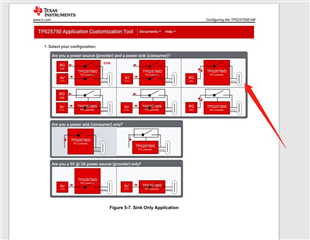

1. My customers would like to use BQ25713 and TPS25750 as both power source and power sink for type C, as showed in figure one in GUI guide. However, in GUI tools we cannot find this option, as showed in figure two, so which option should I choose for customers' use case?

    If they already have a TPS25750 design:
    They should be using the third configuration (top right). The EVM user guide for the TPS25750 is out of date.
