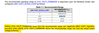

Can you please VERIFY VOUT SCALE LOOP  value for below output voltage's?
1.2V - Vout Scale loop will be 0.5
1.5V  - Vout Scale loop will be 0.25
1.8V - Vout Scale loop will be 0.25
I will write these value through NVMe.

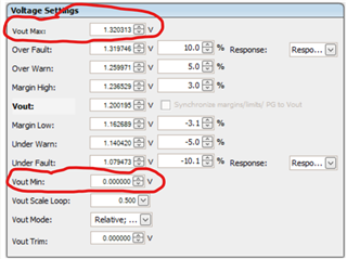

Q2- What will be the VMAX and VMIN values for 1.2V output when vout scale loop will be 0.5
it will 0 to 1.4
or
0.5 to 1.5V
Many Thanks

    They are correct. For 1.2V, you can set VOSL to either 0.25 or 0.5, but if Vout adjustment needs to go above 1.5V, then VOSL should to be 0.25.

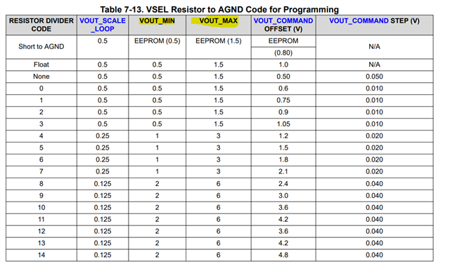

    You can set the VOUT_MAX and VOUT_MIN to either of those, it's up to you. This will ensure Vout doesn't go outside the range specified. The default value will depend on the value stored previously from the pin-detect value you had on your VSEL pin (refer to table 7-13), so you will need to change the value, write to hardware, and store it to NVM on your Fusion GUI.

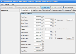

    For Required VOUT 0.92V if i select VOUT SCALE LOOP 0.25 then what will be the impact on regulation?
    Because I have the case where i m getting correct VOUT = 0.92V
    Here is the attached GUI settings-
    I would like to understand how would  wrong valie of VOUT SCALE LOOP will impact the output voltage?
    What is the mean of highlighted section?
    Many thanks
    Rajat
  • Hi Rajat,

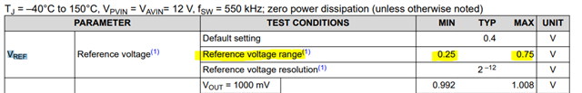

    Yes, you may be able to to regulate to 0.92V still with VOUT_SCALE_LOOP=0.25, but since we don't specify the accuracy of the error amplifier or reference below 0.25V, the tolerance on VOUT will be higher. Also, the tolerance on the OV and UV thresholds gets higher. Therefore, it is important to keep the reference voltage between 0.25V and 0.75V as specified in the EC table.

  • Therefore, it is important to keep the reference voltage between 0.25V and 0.75V as specified in the EC table.
    How to keep it in this range?
    Can you please explain from some example?
    Hi Tom,
    I got it from excel calculator sheet.its clear that if we select VOUT SCALE LOOP =0.25 for 0.92 VREF is going below 0.25
    thanks
  • Hi Rajat,
    The reference voltage is calculated as VOUT x VOUT_SCALE_LOOP. So with VOUT=0.92V, you'd want to use the VOUT_SCALE_LOOP = 0.5, so that the internal reference voltage is 0.46V, which is well within the range.
