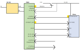

Our set has the following circuit configuration.
When "B" voltage is 13.2V, PMIC's "RESET_OUT" is High Level.
But "B" voltage is 7V, "RESET_OUT" is going to Lo level after 45 seconds form power on.
Then the output voltage levels of DC/DC(5V and 3.3V) are no probrem.

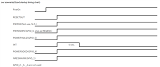

    This will be the scenario we want and the timing chart for NG.
    Each signal line is drawn in it.

    The block diagram is shown below.

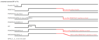

    Observing the waveform,
    [1]First, RESET_OUT goes to Lo level for Sitara.
    [2]Sitara then brings the RSTOUTN to the Lo level.
    [3]Finally, GPIO_0 (REG1EN) of PMIC goes to Lo level and cuts off power supply 3.3 V of Sitara.
    In this state, PMIC will not start even if POWERHOLD is set from Lo to Hi level.

    Waveforms with I2C communication disabled(Left side) and enabled(Right side).
    We thought it would be confusing and didn't explain until now, but our system monitors Sitara's operation by FPGA (IC60).
    If the FPGA determines that the Sitata is not up, it resets the PMIC after 60 seconds (POWERHOLD signal) and waits another 60 seconds.
    If Sitara does not start in the meantime, power off PMIC.
    If I2C is disabled, Sitara does not start and is powered down by the FPGA after 120 seconds.
    If I2C is enabled, PMIC sets RESETOUT to Lo after 45 seconds. PMIC is not restored even if it is reset by POWERHOLD signal.
    Are these differences due to I2C commands (SW_RST bit? , DEV_ON bit?)?
