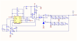

Using the TPS40200 in a 50V input, +5V configuration. Initially was tripping the common mode aspect of I sense pin. Connected small ceramic from pin 5 to 8 and that was solved. Now have an improved layout with this added and the part trips into over current with any load at all, other than no load. The mentioned cap is mounted very close to pins, right next to IC. Removed current sense from the Isense pin and it works, so it seems my new issue is not common mode.
