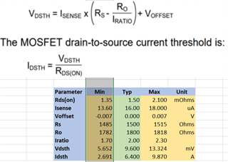

As per the datasheet we have designed Idsth to 6.4A and it is verified in PSpice simulation
But in actual PCB the MOSFET switches OFF at 5.3A instead of 6.4A.
Please let me know why there is a difference.
Below are the calculations
Here is the schematics
