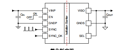

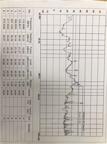

UCC12050 is used below to meet EN55011 Class B, but the there is big noise nearby 200M Hz
then we introudce two inductors to the input as below, the noise nearby 200M Hz is lower, but the noise nearby 30M Hz is much bigger than before, could you give me some suggestion?
Note: due to CF part, Y cap is not allowed to be used in this case.
