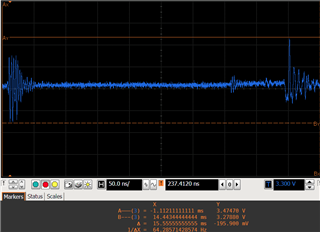

Hi,the ripple of 3.3V is big.It is unstable.
I use the TPS40K tool to change Type III compensator component.
And I try to change the value of R/C,but it can not work well.
Is there any formula for calculating the values of resistor and capacitor?

  • The Excel tool or the WEBENCH ® Design can not work well according to the practice.
    Is there a way for debuging?
    For examp, I measure some wave,and then change some values through calculation according to the wave .
