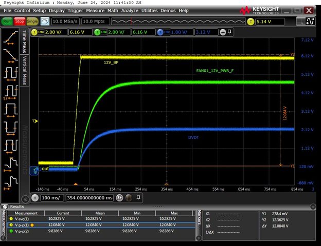

We used TPS259241 for a hotswap design.
1. Startup behavior: the startup waveform looks different when i put passive probe on DVDT pin, once probe is added to DVDT cap, the VOUT ramping looks nonlinear. Can you explain why?
2. Datasheet mentions the TPS259241DRCR is auto retry mode, any more details on how it works? What's the time delay between each two retries? No details from datasheet.
startup with passive probe on DVDT pin (yellow is +12V_BP, green is the hotswap output, blue is DVDT voltage):
Startup without probe on DVDT pin (green is +12V_BP, yellow is the hotswap output):
