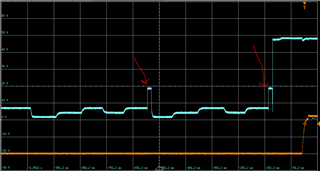

To give you some additional insight, here some of our measurement results. Blue is the PoE voltage at the sink, behind the full bridge rectifier didoes. Orange the output voltage of the PD chipset in the sink device.
First a "regular" power up event. As you can see, the classifcation event is performed 2 times, instead of a single event.
Then for comparison the same device in auto mode, where only a single classification event is seen.
An the last measurement shows the error case where no classification is happening at all. Green and yellow can be ignored, as those are diffential signals used for the blue math function curve.

    If classification is enabled on the PSE, the classification cycle will only trigger once the PSE sees a valid detection result. In both of you captures above, everything looks normal as your classification cycle always triggers in both semi-auto and auto mode.
    For 15W PD devices (Class 0-3), you will see one finger classification, which is confirmed in your screenshots above. Those both look normal.
